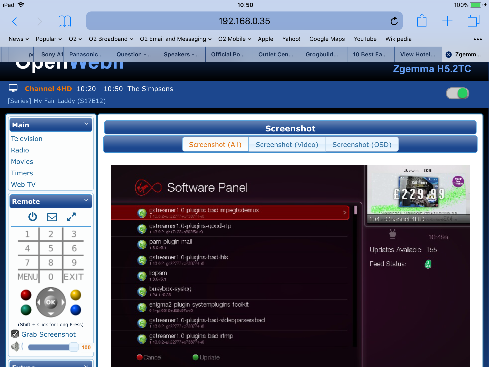

Do i update all of these? Edit i am...
it's all or nothing with software updates:( but yes you can do that, it may say your image is old and erros may occur but most of the time it's ok to continue. I do software updates but then now and again I reflash a nightly build of ATV 6.1 as it keeps it upto date.
