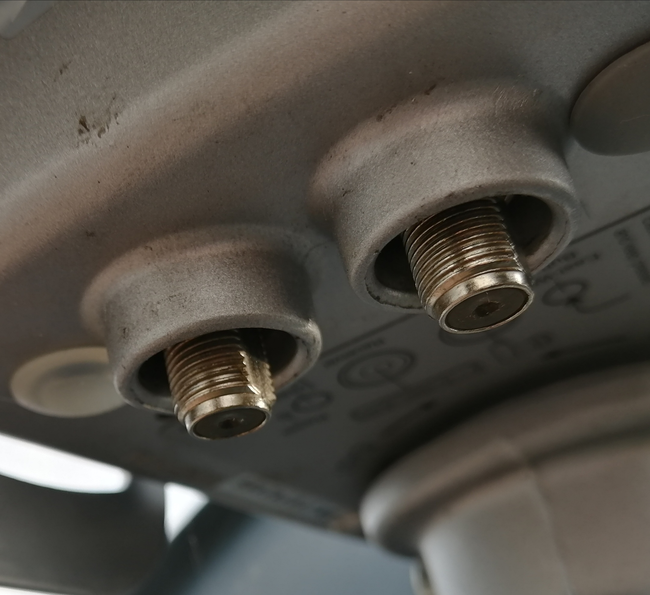

Okay guys and girls panic over some what I went outside to see lead going from dish into motor had come off
Only problem now is that copper from lead is stuck in motor where you screw in f connector any ideas how I can get this out ?? Please advise asap ?
Never had to do it maybe a needle as a pry bar try to push needle into copper.
So did you have the cable too tight and it snapped as dish moved ?
The thread on motor was a bit iffy from went I bought it had to push a little harder than usual and yes I think lead didn't have enough play in it. Any ideas other than tweezers lol does thread on motor unscrew I mean where copper has broken inside
Needle mate other than that you may end up de soldering that one and putting a new one on. I reckon you get it with a needle.

Where copper got stuck in it was always difficult to tighten f connector
How do you mean it was iffy new motor was it not ?
It was a new motor but noticed to connect on to motor had to push harder than other side for it to tighten
A really really, I mean really small self tapping screw, wind it in by hand, it will bite the copper, and not the harder F terminal, only needs about 5mm depth, then slowly pull it out while pushing against the copper,
Anyway I tried two needles tapped in and tried to force out from side of copper wasn't having it so then tried a thicker needle again tapped gently with hammer then pulled out with pliers didn't get anything out so tried with thicker needle to get n through the side of it still nothing fell out.
So tried putting cable with f connector back with aa little force managed to tighten up and now get movement like before but actually get some sats.
Just have to keep an eye on it if it comes loose again at least I know why if it happens again.
Thanks again for speedy reply... (y)(y)(y)

Ive a feeling this will be short lived you need it out somehow.
