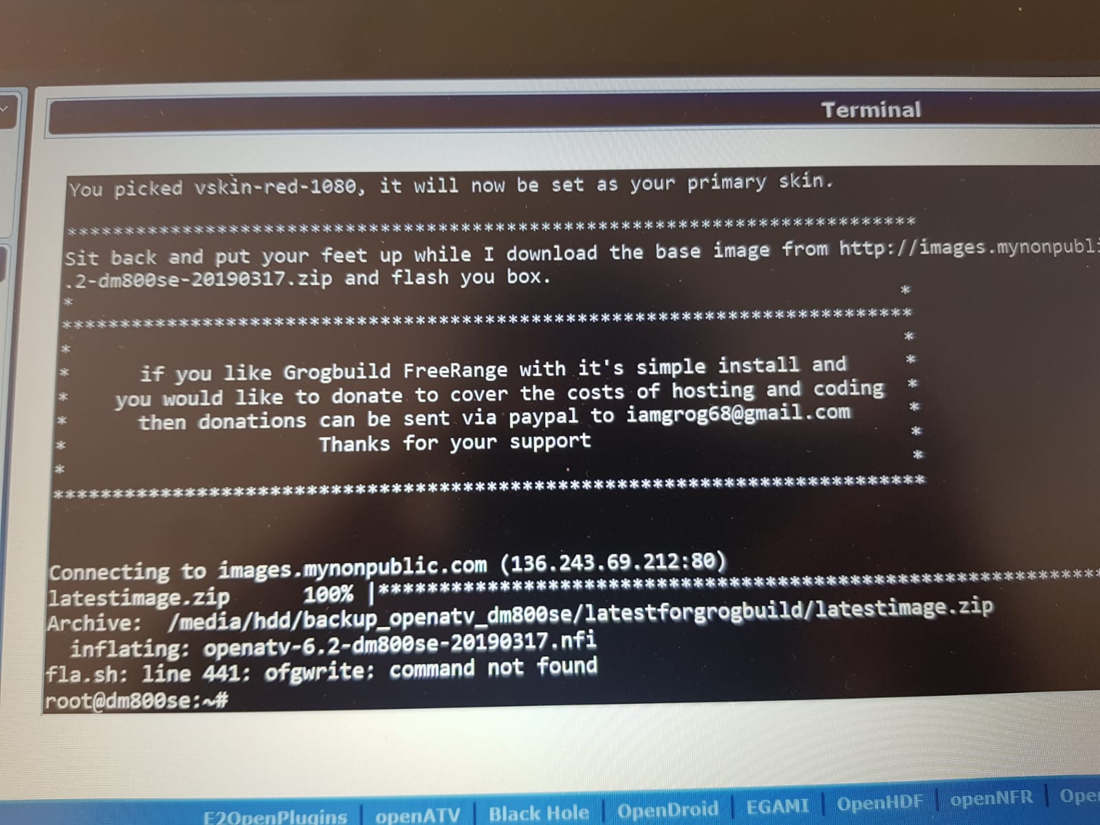

Hi Grog tried installing this on a DM800 hd se but got the error attached. Any idea whats wrong?
what is installed on the box at the moment, the script uses ofgwrite to flash the box during setup and the error is suggesting the box doesn't have it installed.
You could try entering the following line commands:
Code:
opkg install ofgwrite && cd $(find /media/hdd/backup_openatv_dm800se/latestforgrogbuild/  -type d  -maxdepth 2 2> /dev/null|sed '$!d') && ofgwrite  -r -k ./
It should then install ofgwrite and then flash the box and setup using the settings you entered.
Code:
openatv 6.1 is installed

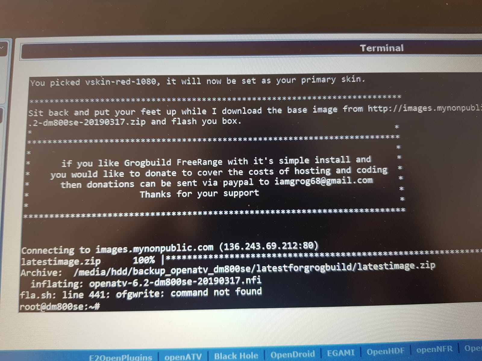

Using the usb from my zgemmah2h (64gb). Can see the recording and timeshift set up correctly. Tried ofgwrite and got the message attachedWhatsApp Image 2019-03-17 at 16.25.12.jpeg
try flashing 6.2 and then use the instructions in http://www.techkings.org/resources/grogbuild-freerange.59/ these instructions work if installing on bare atv image, the instructions in post 1 of these thread flashes latest atv stable image automatically but for some reason this is causing issues on your box
When I wrote the instructions 6.1 was the stable version, it is no longer supported.
I have a clone receiver and cant get openatv 6.2 to install on it. The link pablo gave me is for official dreambox. Any suggestions?
You don't flash a dm800 by usb as you probably know
There are no images for the clone dreambox to enable you to flash grogbuild or wooshbuild
Also the memory and flash memory are not sufficient
