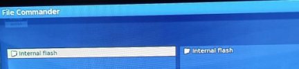

Ok I restarted with my usb stick removed, going into file commander I see:
So don't think there is anything for me to mount.

file commander is not showing any USB/HDD, internal flash is the box's own internal memory by the looks of it
I checked with the manufacturer to be sure to be sure "No, F1 do not have HDD inside and no interface to connect hdd internally. You can only use external HDD with F Series.
